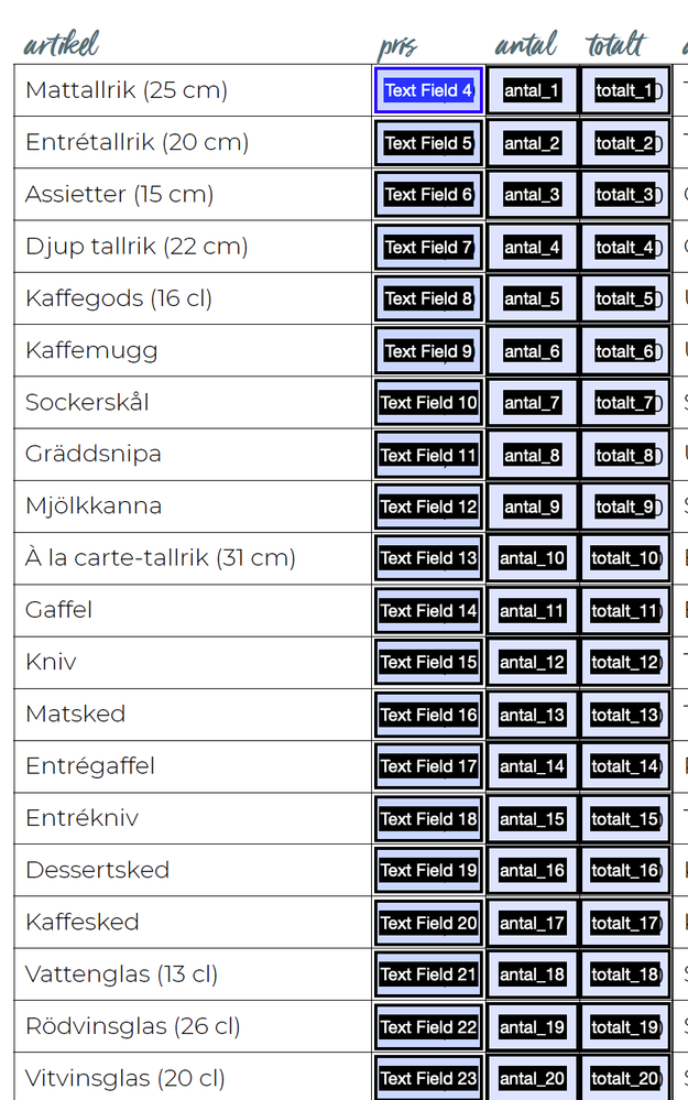

I see. Somehow the naming of the first column started with the number 4 (Text Field 4) but the order is consecutive, please see attached picture. Will it still not work?
Thank you so much 🙂
Aug 20, 2021 Aug 20, 2021
Is the offset with all of the fields 3, though?

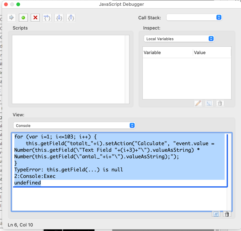

Hi again, tried it out now following your instructions but get the following error: TypeError: this.getField(...) is null. Googled it and it seems this error "means that you are calling a field that does not exist. Check the spelling of your field names in your code against the actual field names (including case sensitive)". I can't find any mispelling or other mistakes, any idea what I'm doing wrong?
Aug 24, 2021 Aug 24, 2021
Yes, it means you have misspelled the name of one of the fields.

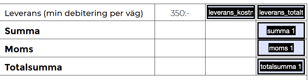

Wow, magic, thank you so much! How do I do the last steps?
  1. Change the comma separator in the "totalt" field to comma instead of period?
  2. Get the sum of all the fields "totalt" as well as "leverans_totalt" in the field "summa 1"?
  3. Get the sales tax (+25%) to calculate from the field "summa 1" (think I've got this actually even though there may me a simpler way to do it)?
And that's it, I think even I should be able to sum up the rest 🙂
Aug 25, 2021 Aug 25, 2021
You can use the util.printf command to set the number to have the desired format, and you can use the convertToNumber method I created to sum up all the total fields.
