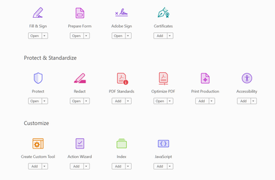

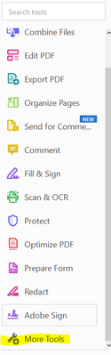

Feb 17, 2022 Feb 17, 2022
I am having this same issue, but I do not see the option to 'Revert Back to Acrobat Form'.  I have followed the instructions and it isn't there.  This is what I see.
I click on More Tools and then, I see this:
I'm using Adobe Acrobat Pro DC, Continuous Release, Version 2020.006.20034
Please help!  I don't want to have to create this form all over again.
Use Prepare Form and you will see More at the right side.
New Here ,
I did.  I meant to say that part.  I clicked Prepare Forms, then More Tools and the final screen shot from my previous post is what I see.
You doesn't have activated the form edit mode.
