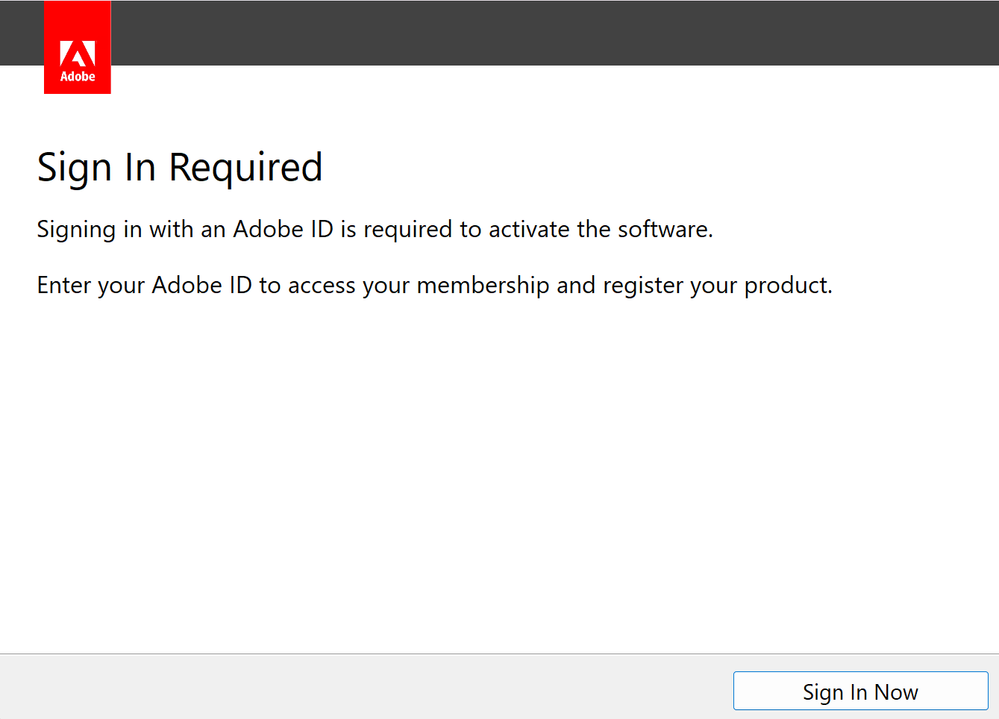

I have recently changed the mainboard of my laptop due to a malfunction. When I tried to open the already installed Acrobat Pro 2020, it asks me to "Sign In" again.
When I follow the "Sign In" button, I am redirected to the authentication prompt in my browser at https://auth.services.adobe.com/. However, as soon as I start typing my email into the authentication mask, it shows me an error that something went wrong.
