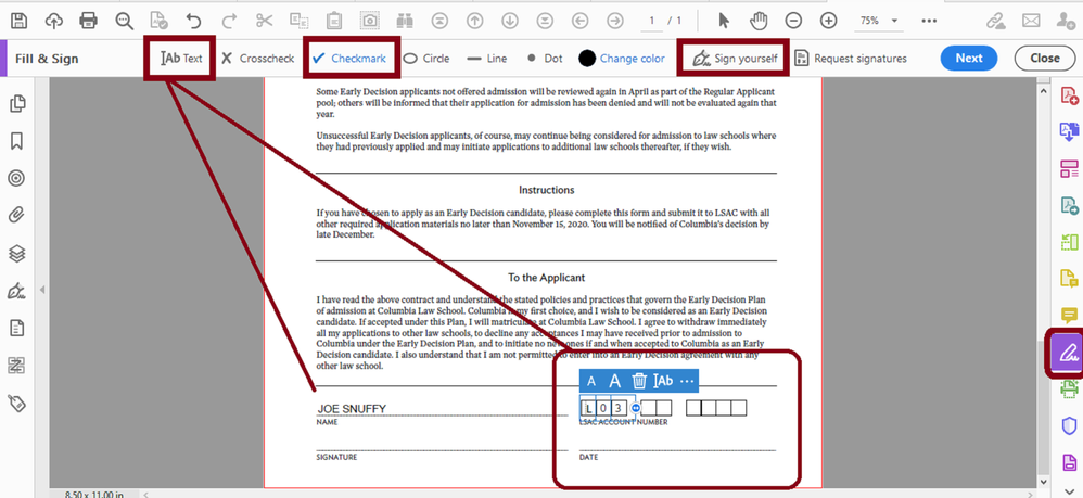

This PDF was produced by Adobe InDesign.
See slide below:
It doesn't seems like the producer created any fillable field objects to begin with.
However, what you have seems more to be like the result of a flattened ot refried PDF.  This could've happened if the original PDF was printed to a PDF. or export as an image file then exported back to a PDF.
You can still edit this form with Adobe Acrobat Pro DC to recreate the fields from scratch yourself, but the correct approach should be to contact the producer of the source PDF so you can download the original.
If the original source is what you have then this form is meant to be filled and sign using the Acrobat Fill & Sign tool, not the Prepare Form tool.
See slide:
