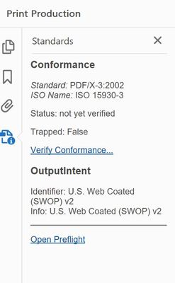

I am trying to check the documents in Adobe Acrobat, but some people mentioned an "Advanced" tab...  I cannot find this anywhere. I only have preflight options (don't seem useful in this case) and an "info" i to the left of the document... this doesn't say outright what the document is, but it recognizes if the document fits to a PDF standard and states the "preferred target ICC profile"... Unfortunately, several of my documents are coming up blank, even though I did specify X3 for each. I am wondering as to why it is not more obvious regarding if the document is RGB / CYMK or unspecified.

There isn't such a thing as a preferred profile in any normal PDF. It's either tagged or it isn't, and if it's tagged the profile is embedded (so it works on other people's systems). HOWEVER, there is a complication. PDF/X has the idea of an "output intent" - as in your screen shot. PDF/X requires this. The output intent is "here is an embedded profile to use for any untagged colours in the file". So the file is tagged, in effect, but not all the colours are changed. There may be workflows (not using PDF/X) where the difference is important.
