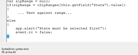

Thom,
It is weird, the debugger keeps highlighting the '{' immediately following 'else.'
It has to be something I did wrong, but I can not find it to save my life.

So what is line 61 and line 62?
Code is very picky about syntax. Each opening bracket must match a closing bracket and they have to be perfectly nested. All elements in a list are separated with a ",".  Stuff like this. Somethimes it's insanely difficult to figure out, and it will be right in front of you the whole time.
I'm happy to help, but you have to give me the exact and complete info. What is on line 61 and 62, what is the exact error message?
Thom Parker - Software Developer at PDFScripting
Use the Acrobat JavaScript Reference early and often
Votes

Also, you do know that
 ... Test against range...
is not real code? Its a placeholder for what you need to add. And it will cause a syntax error.

New Here ,
Mar 16, 2020 Mar 16, 2020
Copy link to clipboard
Copied
Wow. I am even worse at this than I thought. Well, yes - I thought it looked like a place holder, but I figured it needed to be there and the code would populate it with something! LOL
Did I tell you I am a Technical Writer and not a coder?! LOL Well, it is pretty obvious now that no matter what I am - a coder is not it.
Ok, so what do I need to populate that section with? If I am guessing right, it needs to be a reference back to the 'ZipRanges' section. But it also needs to reference what is in the State field first?
The error is highlighting the final bracket in your code.
