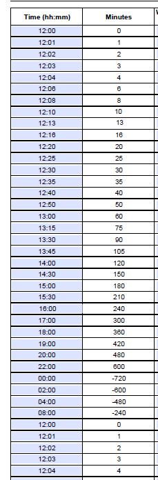

I have a problem with one of the forms I created in Adobe Pro DC.  This form requires a calculation for the minutes field but what I didn't know when creating the script was that the time may go over multiple days, so now I have no idea how to fix it.  I'm hoping someone can help.
I'm not sure if this is relevant or helpful...  I have a start date and and stop date and start time and stop time.  Then each test is to have the time entered when the test was conducted in HH:MM time.  I was using the first entry of these times to calculate the rest of the minutes, but I can see now that if the testing spans over a day or goes past midnight on the first day, than it is not going to calculate properly.  I'm thinking that maybe it would be easier to grab the last minute calculated and then add the next set to that, but am not sure how to even begin coding that...
I'm really new a javascripting and creating Adobe forms and have found some of the coding on-line and manipulated it for my purposes, but I can't find anything on line to help with this particular issue.
Here is a screen shot to give you an idea of what it looks like now (but I am also attaching the entire form):
And the code currently looks like this:

Yes, if it can span more than one day then you have to include the date, as well as the time.
The code will then need to convert the value of the fields to Date objects (using the scand method of the util objects), and then calculating the difference between them is much more straight forward.

If the start time is 9:00 and the end time is 9:30, how would you know if the result is 0:30 hours, or 24:30 hours?
Explorer ,
Jul 02, 2020 Jul 02, 2020
That is a good question.  I do have a start time and a stop time inserted at the top of this table, but not sure if that is something that can be utilized here?    Do you think it would be better to have the user enter the date and the time through a date field?  Would it be possible to only display the time on the form?  What would the coding look like if I'm calculating days to minutes or woud it be generally the same?
