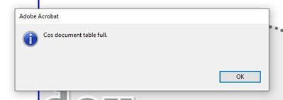

I'm working on a PDF which has a fair amount of mark up (mine) but I now can't add any more, or edit the mark up, because whenever I click on any mark up I get the error message 'Cos document table full'. It's started happening on a few of my PDFs now.

Thank you for the suggestion and detailed explanation. I've just tried that, but the problem still persists unfortunately (screenshot below). Do you have any other suggestions? Do you think it could be corrupted in some way?

Ok. I was just chatting with Tech support for about an hour. Turns out, in my case, there were restrictions placed on commenting by the creator of the document. So having to send it back to get the restrictions removed. One way to test is to see if you can add a comment to a new document that you created.
Copy link to clipboard
Copied
OK. So after some digging (i.e. asking the various parties involved), it turns out it was NOT a permissions issue in my case. Even the original creator of the file was getting the same error message. Instead, it looks like that particular file was corrupted somewhere along the line. I couldn't even extract a single page without getting a Cos document table full message. Went back to an earlier version of the file, and it was fine.

I take it all back! I started working on the earlier version of the file and after adding three comments, I got the "cos" error again. Another 1.5 hours with tech support, and the only thing they could offer was to "sanitize" the document, removing all 874 comments/edits by the authors. I told them this was an unacceptable solution. (They also told me that the "cos" error was caused by too many background calls and that I had "too many documents." because I "hadn't cleaned my system." Because other people on other systems had the exact same problem, I find it doubtful that it was just my background documents that were causing the problem.)
I tried splitting the file using extraction, and got the same cos error. I then tried deleting pages manually, and got another error. I also tried deleting all the comments manually and got the same cos error. Finally, I redownloaded the working version of the file (V3) and was able to split it by extracting pages. Oddly enough, the two split files were MUCH smaller than the original file (which for some reason was 175 MB!). I've thrown all this back to the publisher, in the hopes that Adobe will be more helpful to an enterprise client to an individual. In the meantime, Check your file sizes--I found this problem occurred in files over 100MB. (Also, not sure why the file size ballooned so much--the original file was only 70MB). Splitting a large file into separate files seems to be the only solution right now. 😞
