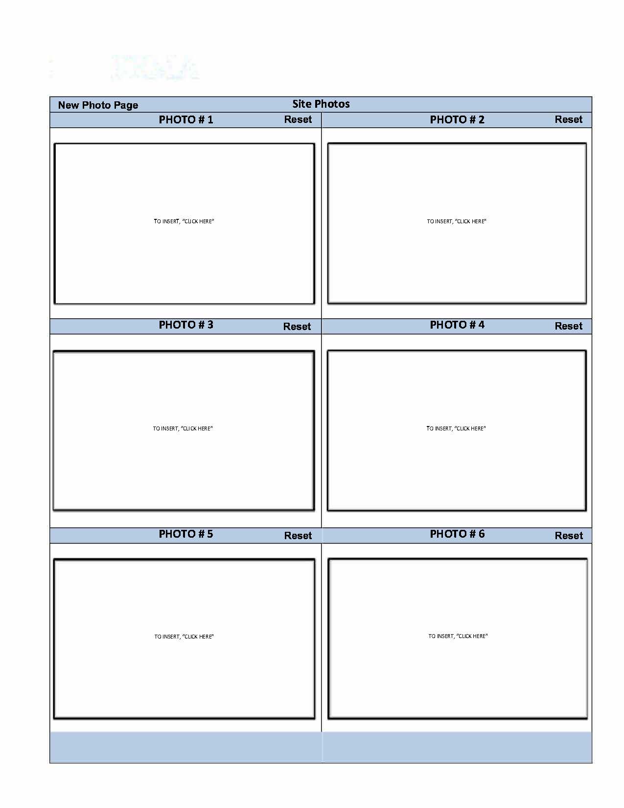

I have a Report Form with a photo page like this:
I create a hidden Photo Template Page to be added as a new page below the original for add more pictures.
The reset button to "clear image" that really replace the icon works great. But when I add it as a "New Page" the reset button didn't work.
I know that is because of the field name that is attached in the form.
My question is, There is a javascript or another way to resolve this issue?
I will appreciate any help.
Thanks

The reset button have 2 scripts;
1. var buttonIcon = this.getField("Click here").buttonGetIcon():
2. this.getField("Image1").buttonSetIcon(buttonIcon);
There is another hidden button with name "Click here" with the Icon.
Thanks
