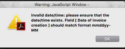

I am trying to change make a custom date and time to function as an "invoice number" so when the user chooses the date from the form Date field it populates as such: ddmmyy-hhmm. When I try to use the Custom format and type in ddmmyy-hhmm I get an error that reads
"Invalid date/time: please ensure that the date/time exists. Field [ Date of invoice creation ] should match format ddmmyy-hMM"
What am I doing wrong?try67​

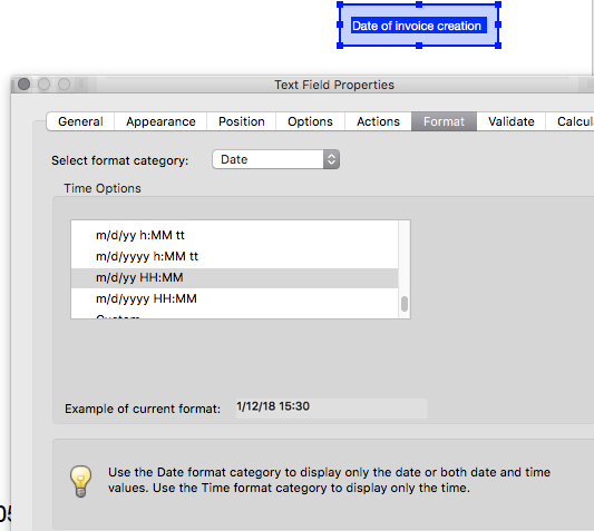

Using the Date Field from the form builder they select the day and the time stamp is added. Currently the same info can be displayed using one of the defaults like: m/d/yyyy HH:MM. I just want that information to look like mmddyy - HHMM.
I can also select "custom" and only have the date show up as mmddyyyy, but I would really like to include the time.
Same info, just reformatted.

Jan 12, 2018 Jan 12, 2018
Then you don't need a Date format setting. You can apply any date format you want in the script that assigns the value to this field.

Ok I see what you're asking. Yes I created the date field but when i try to us a custom date format AND a custom time format I get the error message of:
To summarize: I can totally use custom for the date, but when I try to integrate the time stamp in any way I get the error message. Trying to figure out how to fix that.

Input from the user by way of a drop down arrow (right side of the field):
OK, that's the built-in Date picker, but you won't be able to use it if you create your own custom Format script.

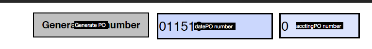

Jan 15, 2018 Jan 15, 2018
Do I add that to my Generate PO number button on the Mouse up action/run Java script? Or at the document level? The screenshot is the button "Generate PO" and i'm trying to get the generated numbers to show up in the acctingPO number field when you execute the mouse up action.
Either way. If you want it to be executed when the button is clicked then use it in its Mouse Up action. If you want it to update each time the file is opened use a doc-level script.
