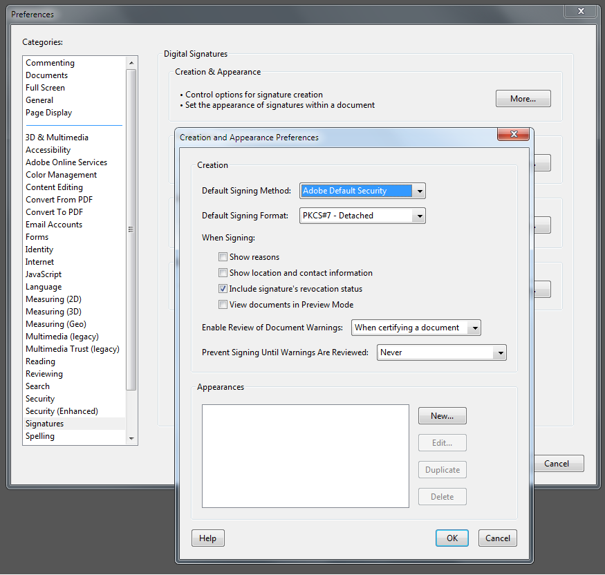

Hi all,
Would you please try turning off the new UI (modern UI) from Preferences -> Signatures -> Creation & Appearance – More -> uncheck “Use modern UI for signing and Digital ID configuration”.
For testing purposes only and check if that fixes your issue. Let us know the result.
Appreciate your patience on this.
Thank You,
Shivam
Guest
Jan 25, 2017 Jan 25, 2017
These options don't appear for me.
Community Beginner ,
Jan 26, 2017 Jan 26, 2017
All,
Unchecking “Use modern UI for signing and Digital ID configuration” is not an option.  That preference is not even available.  It is available in continuous variant of Adobe Reader.  The problem I am having is in Adobe Acrobat DC.
Also, right-clicking on the Acrobat icon and choosing to “Run as Administrator” does not fix the problem either.
I did a few other things to pinpoint the cause of the problem.  I did try this on two different machines running Windows 10 and they work.  This problem seems to only involve when running Windows 7 (I do not know about Windows 8).
On the machines running Windows 7, I uninstalled Adobe Acrobat DC.  I then reinstalled it (it installs version (2015.006.30033).  I tested it out and it works.  HOWEVER, when I updated Adobe Acrobat DC to the most current version (2015.006.30280), the problem comes back.  It seems as though there is a Windows 7 issue with the most updated version of Adobe Acrobat DC.
Could it be that Adobe Acrobat DC needs another updated patch to work better on Windows 7?
