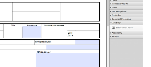

Hi all,
@JR Boulay  from the uploaded example I can see you put the calculateNow() function at document level. I can see that function only if I go to 'Javascript -> Set Document Actions -> Edit all'. In my document, if I click on the above button I can access the entire Javascript document, but saving that Javascript by adding the following portion is not saved on the document.

Explorer ,
Apr 27, 2021 Apr 27, 2021
Attached a screenshot from my Acrobat.
Thanks
Simone

Explorer ,
@JR Boulay my question comes from the tutorial, where it's specified the document-level script can be modified from the Javascript tool. However, if you see my screenshot and my commands above, I cannot access it. I see document-level script when clicking on 'Edit all', but I cannot save any modification.
Thanks
Simone

Explorer ,
That's my issue. In my Adobe Acrobat XI I cannot access that action.
It should be here in Acrobat Pro, so I guess you're using Acrobat Standard.
