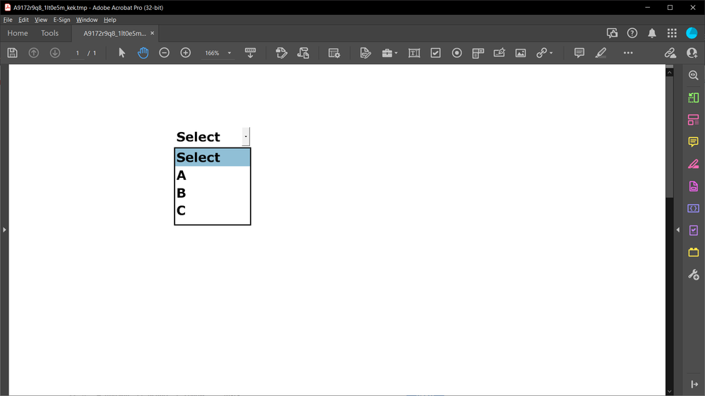

Hi, I am using Adobe Acrobat DC with the latest updates on Windows 11 Enterprise and looks like it has a bug as the dropdown list can not display Verdana Bold font.

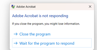

Also, after I use it for a while or open certain amounts of forms, it will freeze and has to close it from the Task manager.

Dec 06, 2024 Dec 06, 2024
Works fine for me:
Did you add the field in Acrobat?

Yes, this is a dropdown list added. When I changed to Verdana or Arial Bold or just , it shows.
Maybe the font file got corrupted. Are you able to use it in other apps, like Word?

The bug is most likely in the form. To use Verdana in a form field, Acrobat must fully embed the font in the AcroForm section of the PDF. If the font is not embedded or it is corrupted, then you would see behavior like you've described.
I'd suggest trying a different font (type 1 would be best) and then optimizing the PDF.  This should remove the problem font. Then try changing the field font back to Verdana.

Hi, the cause is found due to use Foxit to further reducing the form size. Adobe cannot reduce the form size properly sometimes.
thanks
Dec 09, 2024 Dec 09, 2024
So Foxit corrupted the font. Maybe there is a good reason why Acrobat doesn't reduce the file size as well 😉

so far, only dropdown list got corrupted 🙂

Hi, the font issue is fixed and what about the Adobe freezing and crashing after used it for a while?
Thanks
Dec 16, 2024 Dec 16, 2024
How was the font issue fixed?
Maybe Acrobat is crashing because the PDF is still corrupted. You could try running an optimization on it. This will cause Acrobat to analyze the document and fix any issues that it finds. Not that it will find everything.

No, the crashing is another issue once I used Adobe to edit a few forms for a while. The below is the window shown when reopen it after crashing.

The font issue will not be shown if I don't use Foxit to reduce file size further.

Hi, now it is freezing like the below
Adobe Employee ,
Dec 18, 2024 Dec 18, 2024
Hi @Wei
For the freezing issue, please share Acrobat diagnostic logs and share the log ID generated at the end here for further investigation https://helpx.adobe.com/in/acrobat/kb/acrobat-diagnostics.html
