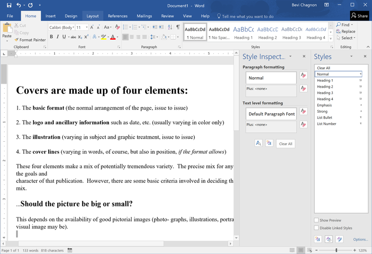

Here's a screen capture of the Styles and Style Inspector panels.
Word's Styles panel (right) and Style Inspector (middle)Word's Styles panel (right) and Style Inspector (middle)
Let us know if this solves the problem for you.
