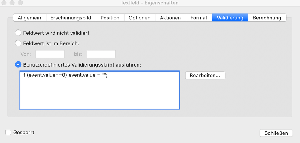

Thanks for your quick answer.
Your suggestion that i'm using the automatic calculation is correct.
But honestly i don't really know what to do right now. Is that correct what I´ve done here? (as you can see on the photo below)
Nov 25, 2020 Nov 25, 2020
Yes, that's correct.
