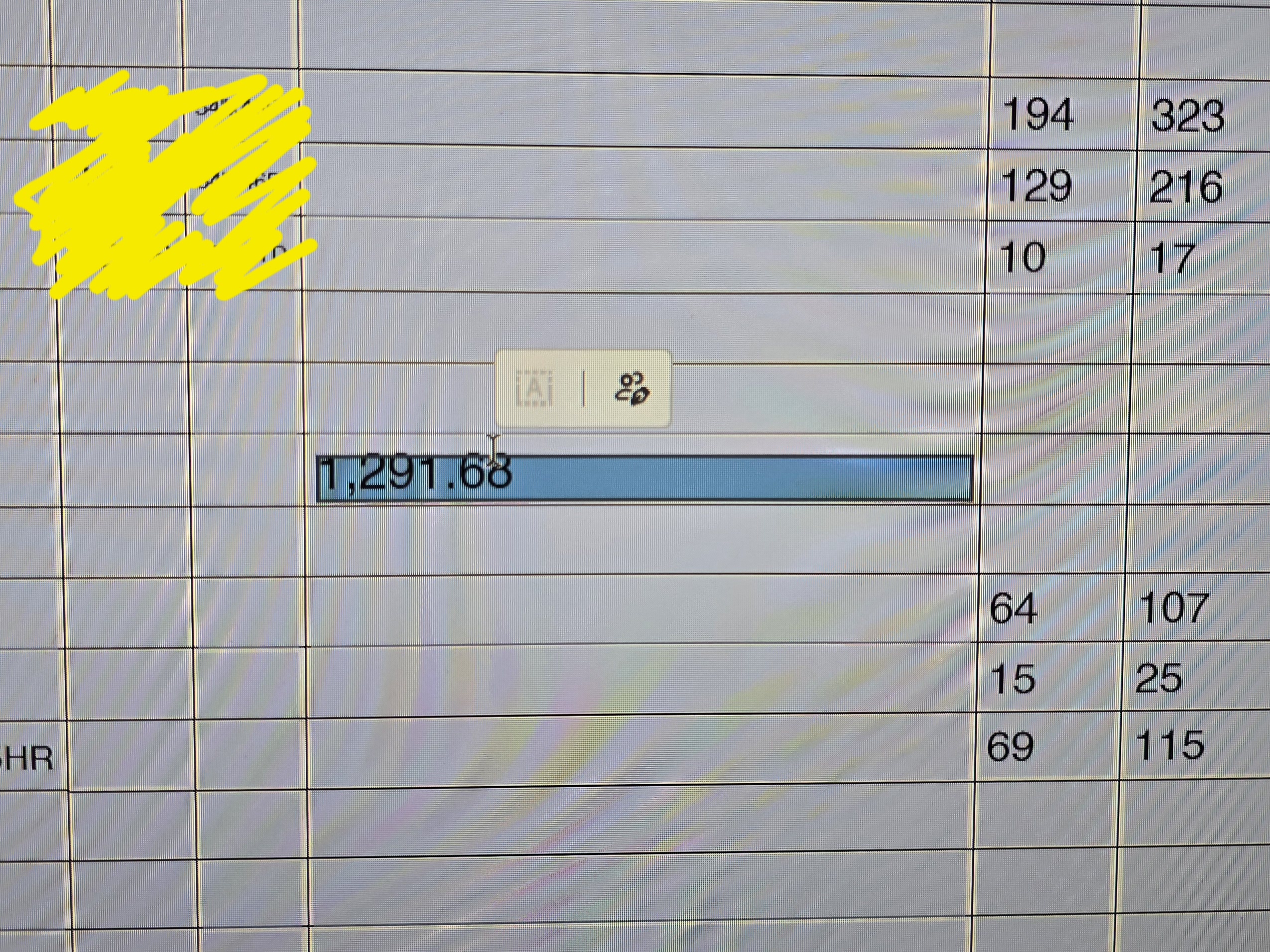

I have a fillable form that has recently stopped letting me click on the field and let me type into it.
I have a picture attached for reference.
It will let me click into the field and then another blue box will pop up along with a rectangle that, when you mouse over it, it has the "fill in form fields" symbol to the left and "request e-signatures" to the right.
It already shows the "fill in form fields" symbol as being greyed out, as if I can already type into the field however, not even a cursor shows up when trying to click repeatedly in the field.
I have found that, if I right-click in the field, it will then show the cursor with just the original field, no secondary field inside of it, and will let me type into it.
I have checked security settings and also e-signature settings and everything looks good.
To be clear, I am NOT looking to have e-signatures anywhere on the form and it is NOT setup for them either.

In order to allow my users to click in the fields with the mouse, they must first open the e-signature panel (tool that shows in SageGrimm02 post above, then a message pops up which states "The author of this form has specified the fields which you can fill. Click on any field to start filling form."
A second menu QUICKLY pops up overlaying this one. That must be cancelled. (screenshot 1)
Once "OK" is clicked on the original pop up message, you can proceed to complete the form by click and selecting fields --- UNLESS you happen to close the E-sign menu. At that poimnt hte whole process begins again.

SageGrimm02's picture showed exactly what I experienced, with the extra blue box appearing over top.  (I'll note that for larger height boxes in my form, the extra blue box was always 1 row in height, often, but not always, aligned near the top of my form box.  I believe that the blue box overlay appears where the initial form field was added when the form was created -- for blue boxes aligned near the top of my large height form box, they're fields I would've dragged down to make larger.  One blue box is aligned near the bottom of my large height form box, which is the only one I think I originally dragged up to increase the height when creating the form.)
