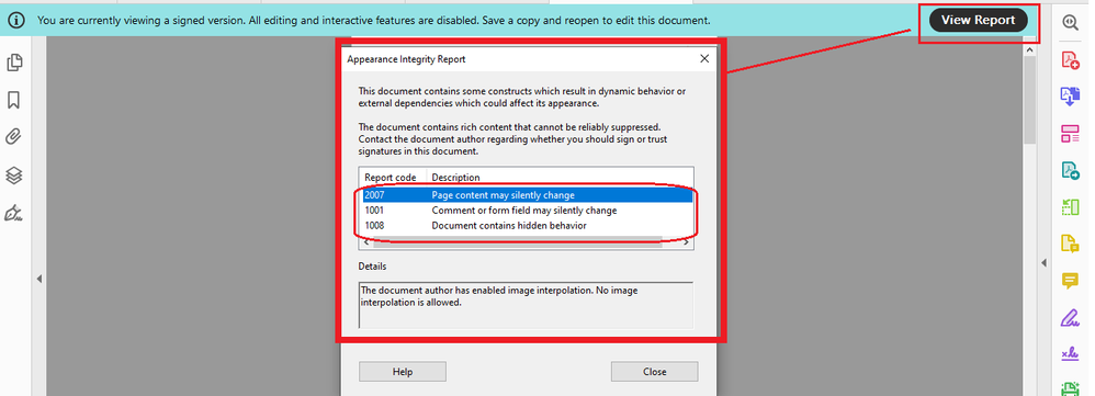

The Signature panel will tell you if there were any changes prior to signing, and you can view the previous signed version.

https://helpx.adobe.com/story/help/track-changes-settings.html  <<-------- how to see changes made in a document
https://helpx.adobe.com/acrobat/using/validating-digital-signatures.html <<--------how to validate sigantures applied in a document
