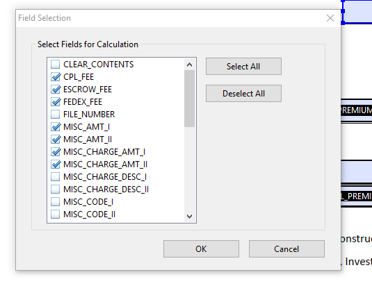

Im trying to make "TOTAL_FEE_TRANSFER" the calculation field.  It would equal the sum of the following fields:
"OUR_PREMIUM"
"OUR_UCC_PREMIUM"
"ESCROW_FEE"
"CPL_FEE"
"FEDEX_FEE"
"SEARCH EXAM FEE" (realized i messed up my naming structure on this one, my bad)
"RECD_FEE"
"TRANSFER_TAX"
"TIEFF"
"MISC_CHARGE_AMT_I"
"MISC_CHARGE_AMT_II"
"MISC_AMT_I"
"MISC_AMT_II"
I'm able to check the fields, but once i select and press "OK"...
The values do not show in the box, and does not calculate on the form.

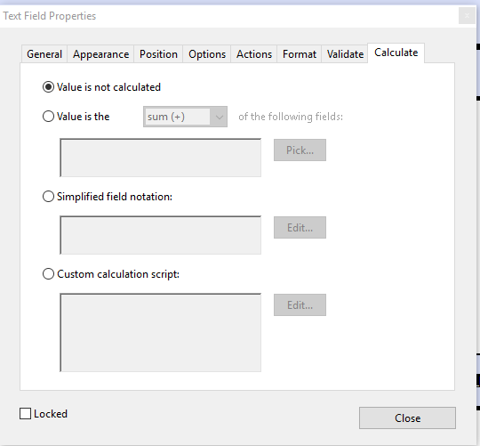

Thanks for answering Thom.  The calculation is what im trying to accomplish.  I tried just selecting only one input field with no field showing in the greyed calcluation box.
I also tried creating a brand new form from scratch and still have the same issue.
Since it worked for you, could it be a problem with my acrobat program? Im running Adobe Acrobat XI Pro on a windows 10 machine.  Im guessing its not a document type issue, as its a standard Adobe Acrobat Document.  I ran repair on the program in windows 10 control panel and it did not fix the issue either.

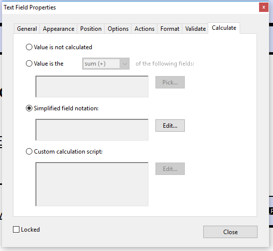

It looks like simplified field notation suffers the same issues.  I can select the simplified field notation button and click edit....
Then I can type into the javascript editor...
But once i click OK, nothing shows on the text property fields and moves the radio button to value is not calculated.
