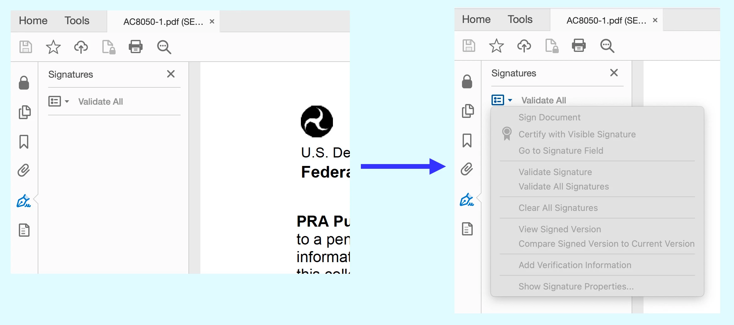

7. With that signature still selected, I look over on the left side vertical tool panel, see the "pen with signature tool" icon; hovering over that tool, the tooltip says "Signatures: Verify signatures added to this document" and that looks like what I need.
8. I click that tool and the Signatures panel slides open. Under Signatures, I see a (certificate?) icon with a disclosure triangle, labeled "Validate All". The label appears to (maybe?) be greyed out (hard to be sure). When I click the text, nothing happens, so I assume it's disabled. When I expand the disclosure triangle, a (disabled) menu pops up, which has 10 items on it. This look like the functions I need, but every one is grayed out (disabled).  Menu items include:

Here's what the Signatures panel looks like when I open the document (I don't see any way to open the Signatures panel within Acrobat if no doument is open):
Note that all items on the dropdown menu are disabled. But I see nothing there like "Unsigned Signature Fields."

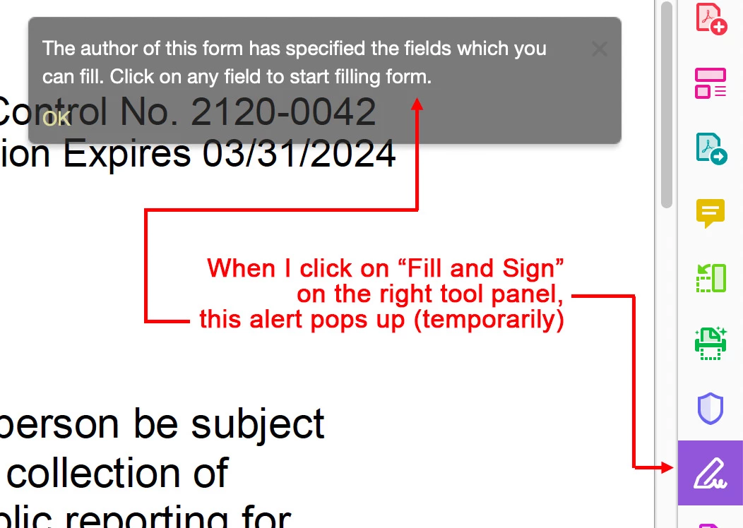

When I click on "Fill and Sign" in the right-side toolbar, a popup appears in the upper right corner, like so:
That's the only notification I see when opening the document.
