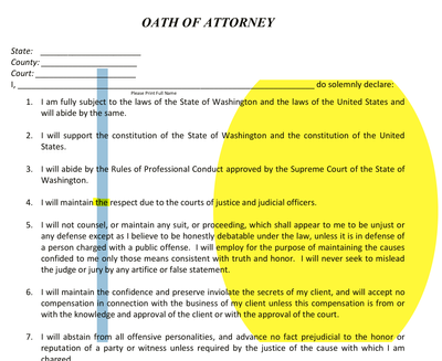

Ok, I have Adobe Acrobat Pro DC. I'm trying to highlight a short sentence or even just a word in a PDF. When I take the cursor over what I want to highlight, I get this oval shape, covering like 10 lines. It's HUGE. How can I make it highlight just the one area on the file? And sometimes it becomes a combo of shapes and sizes
How do I fix this? Where do I go to change the height of this thing and make it just cover the selected text?

Bernd:
I found the fix for it by selecting the "Save as PDF" in the print dialog box instead of using any other Adobe PDF options that may appear. That corrected the issue. I have attached a screenshot for you to see what my options were.
Greg

However I guess the problem is this PDF itself. If you select a text the highlighted area is already very huge. There seems to be something wrong with the font used in this PDF. Its actual height is much more that it appears to be on the screen. That's why the commented area is also that big.

Kayla:
The ONLY feature that you can use to make your PDF documents work with the new Acrobat is the "Save as PDF" command. The print to PDF will leave you with the same issues you are having now. I had to figure this out for myself because the new and improved version of Acrobat is not user-friendly at all.
Greg

The Adobe employee is trying to have you reinvent the wheel. I found the fix for this problem a couple of years ago and posted it below for everyone's convenience. Instead of Adobe fixing their issue, they have Amal making you leap through hoops like he is helping when he is just wasting your time. Here's what you do to correct the problem simply...
There is an anomaly in the Acrobat software. Adobe knows about it and has yet to correct the problem for almost 3-years-into the problem. The fix is a simple one and has been posted by me at least once, probably twice, higher up in this thread. When you want a document from the internet or email, simply select the print option, and then under the printer type, select "Save as PDF." See the attached image
Congratulations. You have now performed a workaround for your problem.
