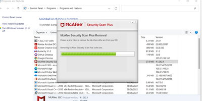

Sep 02, 2022 Sep 02, 2022
Thank you, worked a treat, so simple right lol and only spent 20mins tops looking for this solution but read a few curly ones. Gotta love the blackhole of the internet. Uninstall Mcafee Security Scan 2.png
