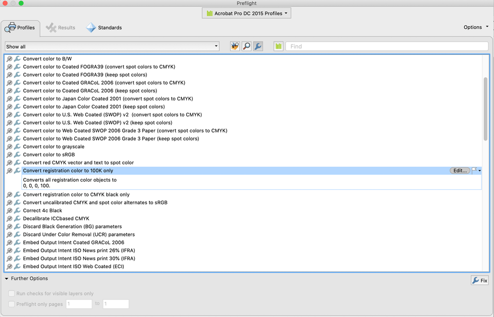

In your sample page, the black text is 100% black and the red text is 100% PMS 220U. The crop marks however are registration (100% of all used colors). Some digital printers charge per color, so I'm assuming you want to change the crop marks to 100% black. You can easily do this with a preflight profile (Tools> Print production> Preflight> Fixups). If there are other 4C black elements in your document, you can use another preflight profile to map the specific color to black only. If you don't need the crop marks, you can place the PDF into InDesign using the place multipage PDF script and export to a new PDF without crop marks.
