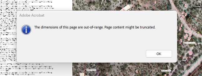

Explorer ,
Mar 23, 2024 Mar 23, 2024
Didn't work for me.  I get this notice, hit "ok" and the pdf still isn't flattened.  Maddening.
