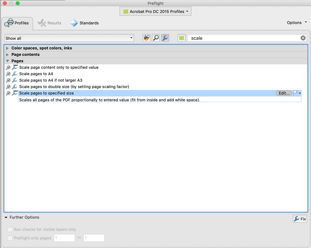

You can do this with Acrobat Pro.
Go to Tools> Print Production> Prefilght> FixUps (blue wrench icon)> Pages.
Select Scale pages to specified size
Go to the little fly-out menu and duplicate the prefilght, give it a new name.
Click on Edit, to change the desired final trim size and the method used to get to this size (scale, white border, etc.)
Click on Fix to apply the change.

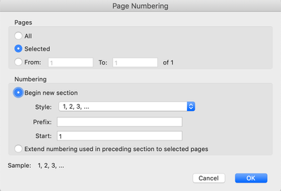

You've mentioned
But in the Page Label (page numbering) dialog box, there are only Pages and sections.
I don't know know what you mean by items or pictures. A screenshot would really help. Or even better yet, several screenshots, one of each of your three "Section" PDFs.

You can use the Preflight tool to scale all pages to the same size.
Copy link to clipboard
Copied
Where to go in preflight menu ?
Can you elaborate ?

You could use an Acrobat preflight fixup to specify the page size (Tools> Print Production> Preflight> Fixups (blue wrench icon), type "scale" in the search field. You can also duplicate and re-name the existing preflight and then edit it to access more options.

I get as far as the little blue wrench and there is no option to scale pages 😞
