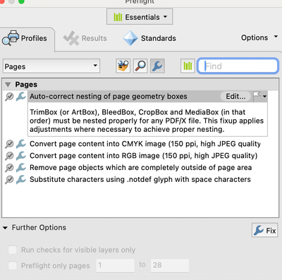

Aug 12, 2025 Aug 12, 2025
Why is it that no matter what I do I cannot find "scale pages". I'm on a mac and the print thing doesnt work either.
You didn't copy the setting exactly.
Thank you @Dave Creamer of IDEAS ! but now I'm stuck here on the edit after duplicate.  Just trying to get the entire file to be 8.5x11 and dont get why its so difficult.
