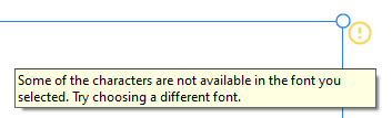

Nowa38986102ctws_0-1722784233150.png2.) Also, on an unrelated note whenever I set the font to be "Mangal", I get the following error message alongside the text box (although other Hindi fonts like "Devanagari" just don't work)

Hey! It is me @LowNowa replying from an alternate account. @creative explorer I had tried the above mentioned solutions already. It is not that the text is garbled up when I reopen the document upon saving and closing it, it is that when I click on the text box and try to edit it, it gets garbled up. Also, I have already enabled the setting to embed the fonts (as I have provided the screenshot in my query) .
