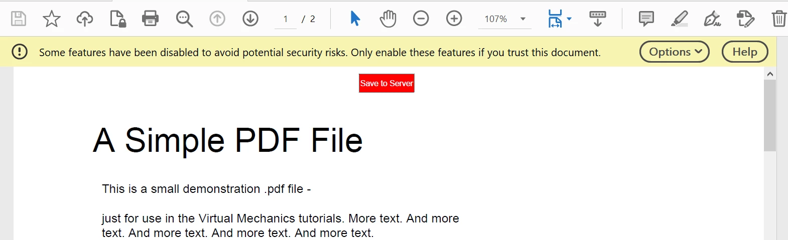

Currently we are returning the server reponse as application/vnd.fdf format which is causing trust issue.
The FDF response is showing trust issue in Abode.

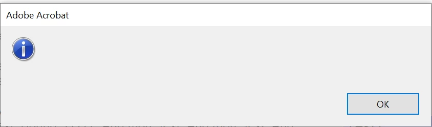

We also tried plain text return from Server (like "Save Successful"). But in Abode we are getting empty alert.
Is it possible to hide the submit response in abode so that the end user will not get trust issue or empty popup?

* Issue 1- Returning a server-side response in real-time to an opened PDF document that is hosted securely in the client's Adobe Acrobat program
* Issue 2- Suppressing the built-in security warnings and alerts in the client's Adobe Acrobat host program
I'll begin by identifying first Issue 2:
* The client-side script may allow user-console level messages, but the same is not true when you try to suppress the built-in JavaScript core security warnings and messages through a non-privileged Acrobat JavaScript scripting context.
Furthermore, Issue 2 forks into two other considertaions of interest:
* Issue 2A - To completely suppress the built-in security warnings and messages, it has to be done manually at the operating system level by editing registry preferences on each client.
This, however, may be accomplished in bulk at the domain-level and enforced with GPO.
In order to succeed you may need to deploy a custom installation of Adobe Acrobat Pro on each client and define a group policy template with the modfied registry keys for each client... not a trivial task!

Tried no response from Server. But in Adobe we are getting this error on submit.
Could you please share an example.
