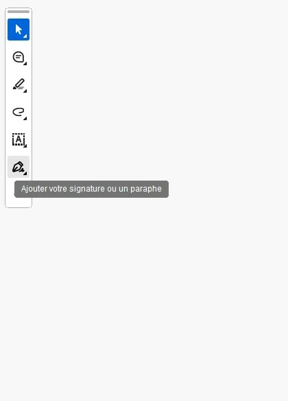

Bonjour,
Comme indiqué, la touche ne fonctionne plus. Dès que je clique: le programme se coupe directement ou bien freeze et me demande d'adresser un rapport d'erreur (ce que j'ai fait à plusieurs reprises).
J'ai essayé tout le reste: désinstaller/réinstaller, réparer l'installation, mettre à jour: rien ne fonctionne...
Pourriez vous m'aider ?
Merci d'avance
Correct answer Meenakshi Negi
Hi ANTHONY38715947cer2,
Thank you for sharing the screenshot.
In the Appdata, open the Roaming folder instead of the Local folder.
Or you can copy and paste the location "%appdata%\Adobe\Acrobat\DC\Security\" in the run window. Press the Window+R on your keyboard. And then paste the address in the box for "Open". Click on the OK button.
Let us know if you experience any issues.
Meenakshi

Meenakshi Negi
July 22, 2024
Thank you for reaching out and reporting this.
The team is aware of the issue and is working on the fix. We will update you once the fix patch is available.
In the meantime, try the workaround mentioned here.
Please go to the location mentioned below and delete the following files:
%appdata%\Adobe\Acrobat\DC\Security\acrobat_fss_signature_initials
%appdata%\Adobe\Acrobat\DC\Security\acrobat_fss_signature_initialsi
%appdata%\Adobe\Acrobat\DC\Security\acrobat_fss_signature_initialsk
Let us know if that helps.
Meenakshi
