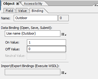

Hello Everyone,
I have over 300 fillable PDF forms that are all the same version, though the content and answers differ. These forms contain various types of fields, such as textboxes, checkboxes, and dropdowns.
I’ve encountered an issue where some checkboxes are selected (X), but after extracting the data using the "Merge Data Files Into Spreadsheet" option, the value for these fields appears as (0) instead of (1). Given that there are over 200 fields per form, many of which are checkboxes, it’s not feasible for me to verify each field manually. However, I have found that over 90% of the data extraction is accurate, though in some cases, selected fields are still showing as (0) in the output. When I inspect the form in "Designer," it indicates that the selected value should be (1).
Could anyone provide insight into why this might be happening? I would upload the form for further examination if privacy considerations allowed, but unfortunately, that's not possible. Any advice or suggestions would be greatly appreciated.
Thank you!

@PDF Automation Station thanks for your suggestions. I don't know how to run in the console but the screenshot of the scheckbox value from the Designer is attached (if it helps)

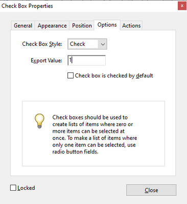

This forum is for Acrobat.  I don't know what that screen shot is.  If you have Acrobat, press Ctrl + Shift + 7 to enter form editing mode, then double-click one of the check box fields to see the properties. Then look at the export value.

Aug 16, 2024 Aug 16, 2024
What do you mean with "Designer," ?
New Here ,
Adobe Designer (Adobe Experience Manager) for building dynamic form
