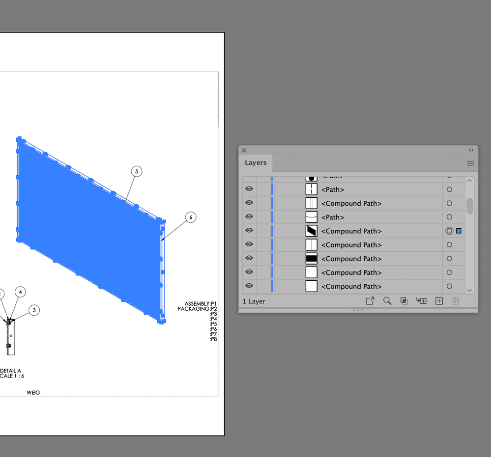

Apr 18, 2022 Apr 18, 2022
Your pdf prints fine for me here on a Mac. The object in question is one compound path (as can be seen in Illustrator), so it appears Acrobat is not rendering it correctly for you & your client, I don't know how to fix this in Acrobat, but perhaps someone else knows a fix. Do you see a print option to "simulate overprinting"? (under Output), does that help? Another option would be to export your PDF as a high res image from Acrobat, but that would create a much larger file.
