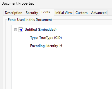

One thing I have noticed is it appears to be isolated to PDF files that only have this font in the Fonts tab of the document's Properties.  If I try to combine file that have other fonts, they seem to work correctly.

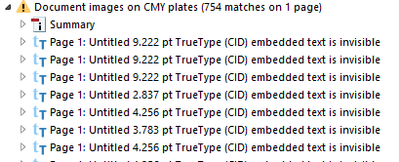

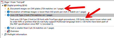

Thanks all for your replies and for informing me about Preflight.  I compared a problem PDF to one that works correctly.  Preflight showed these two errors on the problem PDFs
Does this help with troubleshooting?  Anything I can try as a workaround?  Thanks!
