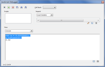

Nov 16, 2021 Nov 16, 2021
> for instance the real number is: 3.01538461, but the field with the script you sent displays this value: 3.03
This is not what I'm getting. See:
