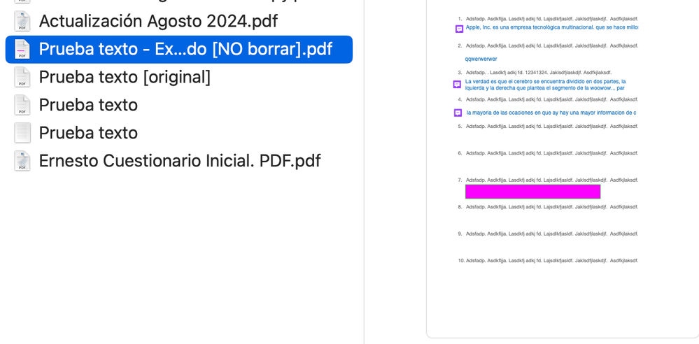

Thank you, your guidance has been very helpful.
What I have also tried, is to change the lilac color of the text box, but when changing it, the modification is only visible when selecting the file icon and showing its preview, and in fact, I have no idea what this function is for (I can only think that for the user to see in the thumbnail, which is a form) ... since when opening the file, this change is not visible, the text box returns to be lilac. Perhaps, the color of the box can not be changed.
What I wanted, is to change the lilac tone, to blue color, because it is part of the corporate colors, and it would not interfere with typing because the box disappears when you start typing.
Here I have selected these colors to make the changeover test
However, in the opened file, only the color of the frame changed
And here is the preview, where you can see the green and magenta frame of the selected fill.
This is probably how things are supposed to work, and I just don't know of any further use for those functions at this time. Although once the file is open, being able to change the color of the text box to corporate colors would certainly be useful.
