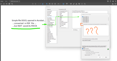

Hi @kirsten_1908
Thanks for reaching out. Sorry for the delayed response. Since I don't have access to your document, this could be for various reasons.
  • PDF/A is an archival format. It requires that the file be completely self-contained:
    • All fonts must be embedded.
    • All color spaces must be explicitly defined.
    • No external dependencies.
  • One of these requirements is an Output Intent — essentially a description of the color profile (e.g., sRGB, CMYK ICC profile).
  • If the document doesn’t have one defined (like in your simple DOCX → PDF), Acrobat cannot finalize the PDF/A conversion and throws this error.
How to Fix It:
You need to add an Output Intent (color profile) in Acrobat before converting to PDF/A.
Option 1: Quick Fix during Save As
1. Go to File → Save As Other → Archivable PDF (PDF/A).
2. If prompted, Acrobat will try to assign a default sRGB IEC61966-2.1 profile.
3. Confirm and save.
Option 2: Manually Add an Output Intent (via Preflight)
1. Open your PDF in Acrobat Pro.
2. Go to Tools → Print Production → Preflight.
3. In the Preflight dialog, search for PDF/A (e.g., “Convert to PDF/A-1b”).
4. Before running, click the wrench/edit icon and ensure an Output Intent (like sRGB) is selected under Color Management.
5. Run the profile → Save your file.
Option 3: Set a Default Output Intent
  • In Acrobat Preflight preferences, you can define a default Output Intent (e.g., sRGB).
  • After that, Acrobat won’t complain every time.
Important Notes
  • Even if your PDF does not contain images or colors (just text), Acrobat still requires an Output Intent for compliance.
  • For archival (PDF/A-1b is most common), usually sRGB is fine unless you specifically need a print/CMYK workflow.
In shortthe error occurs because your PDF does not have a color profile (Output Intent). Add one (sRGB) in Preflight or during Save As PDF/A, and it will work.

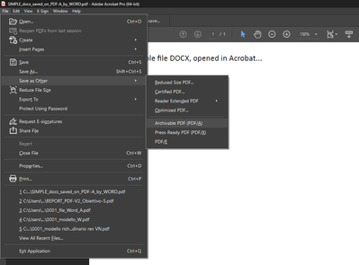

Explorer ,
Oct 25, 2023 Oct 25, 2023
Dear colleague S.Souvik,
as first - I thank you very much for your courteous reply, and as a second - I apologize to having answered with a wide delay, I had to focus on other goals and now I went back to the old problem of Acrobat.
On the subject with the first demand: "No intent of defined outputs_____crobat pro_save as other__pdf/a";...
Of course, I am attaching the simple file, which I would like to convert to PDF/A. But Acrobat Pro, does not allow me - always reporting myself a mistake:
"No intent of defined outputs. To convert to PDF/A Pdf File, an intent of output is a net. Define an intent of output in preliminary verification preferences. " (I attach the screen).
I can't resolve this replied, despite I have an acrobat pro.
Thank you in advance. And I wish good work.
