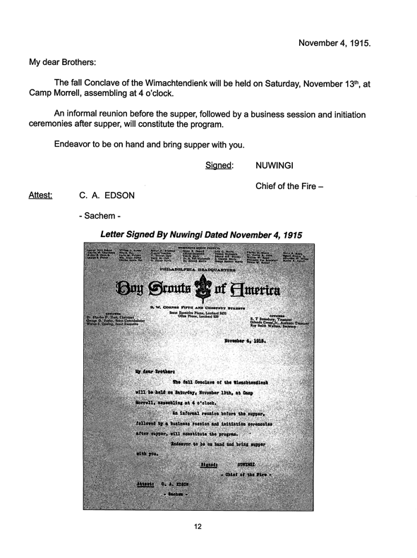

I am OCR a scanned book that has many embedded documents. I will be exporting the scanned documents to Word for further editing, but I want the embedded documents to be left alone (I want them saved as images, not as scanned text). Thus, problem 1 is I don't want Acrobat to try to OCR these scans. Problem 2 is that when they are scanned, they result in lots of queries in the "Correct Recognized Text". Right now, I am just spending a lot of time deleting the suggestion and hitting <cr> for "Accept". This is very time consuming.
The only solution I see right now is to just to do this repeative task for every image, export it and hope that it saves it as an image on the page, and then cut and paste an image for those it doesn't. (Sample page below–one of the easier ones).
I hope there is a better way!

Sadly, that didn't work. I couldn't select the OCR text and selectively delete it. However, it did lead to a rather convoluted process that gets me 90% of the way there. I just need help to finish it off.
1) Set the OCR to Searchable Text (Exact), and Recognize Text
2) Close, save, and open Preflight
3) Select the "Acrobat Pro DC 2015 Profiles" and search for OCR in the Preflight search
4) Select Make OCR Text Visible then click Analyze and Fix
5) Save and close Preflight
6) Open Layers panel
7) Command-Mouse Drag to select all OCR fields under images and delete.
Great, it now is exactly what I want, but I can't successfully export it. I am not sure if I have tried all the combinations of toggling the invisible OCR text layer on/off, and whether I flatten, merge, or leave it alone and then export to Word. But every attempt has either resulted in just the original page images, or the text overlaying the original page images. I did turn off the "recognize text where necessary (?)" option in the export, as it seemed reasonable.
I should mention that I am doing the post in Mac Pages if that matters (I suppose I could get Word - urp), and with great difficulty I can select the underlying images and leave the text, but this is not easy.
thoughts? but in any case, thanks for the help so far. It definitely pointed me in the right direction.

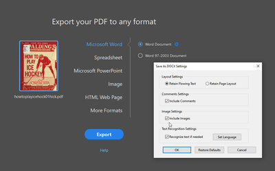

Hi @dancingjewel, I've done several of these types of jobs. Under Tools (more tools) find "Export your PDF to any format." I highly recommend exporting to Word first to clean up the text (or try rich text). Turning on invisible characters in Word and using find/replace is a big help.
In Acrobat, you have the option to export to Word with or without the images. Depending on the document, if you export with images, you can use those as placeholders. Then, export the image files separately. You can set a size to exclude as well. Then, you have a folder of image files you can retouch and convert in Photoshop, finally placing them into an InDesign file properly after mapping the Word document text in.
For documents and letters that are embedded in the PDF that won't extract directly as images, you can drag and highlight the area, right click, and save image as. Sometimes, the only option is BMP, which can bring on its own set of problems when trying to get them to look right. Either way, you will probably have to batch convert these types of images if there are a lot of them. Yes, these projects can become labors of love with many repetitive tasks, but there are some automations to take advantage of. I find them very satisfying! If I can help, please let me know.

I appreciate your advice! I am hoping it doesn't come to that. As I mentioned above, I made the OCR text visible and deleted any image where OCR had been done (thankfully, with my first Chapter, there were only about six images that caused the problem, the other images in this Chapter were seen as images.
So, I am left with a file with 2 layers: One with the page images, one with the now visible OCR text. The problem is now in the exporting, where I have either exported just the page images and no OCR, or the text overlaying the page images. When I export the original file before opening the layers, I get the text and images (but probably NOT the images that were OCR'd. Hadn't thought of that possibility.
Still, the question is can I now "combine" the layers some way to get back to the original format. I have tried both flatten and merge, and it hasn't worked. Trying to contact Adobe Chat, and it tells me it's a 5-10 minute wait. That was 95 minutes ago. Might just try calling tomorrow, not much else to do since we are expecting 6" of snow tonight.
Otherwise, perhaps I can try to NOT delete then OCR under images, but just export as is, and then I would only need to capture those images that weren't seen as images in the first go. That might save some time!
