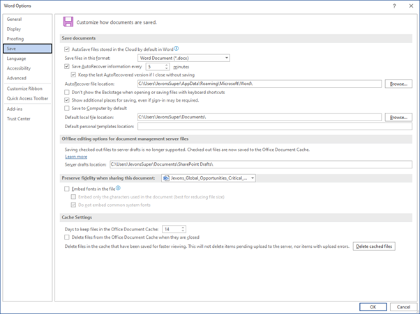

I chedked the Word Options "Save" configuration and that is NOT embedding in fonts.

So, my problem was solved by *going around* a problem with Acrobat DC to choose fonts it would play well with. On the other side, many folks on this thread have commented on problems with MS Word and needing to switch off font embedding. This seems to me like a dumb idea because then you cannot share the source Word document with other people! In fact, the whole thing worked together if I stuck to these rules:

3. Go ahead and embed the fonts in MS Word and in Acrobat via the CreatePDF preferences. The tests at step 1 will isolate any problematic fonts and the measures at step 2 will avoid bogus font embeddings due to the idiosyncratic way that MS Word attaches a "font" to things that are not fonts (whitespace).
