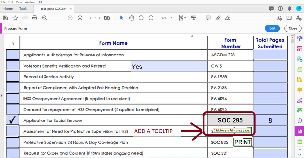

Below is a screenshot of the 2nd page of the PDF file (this page is referred to as the "journal"). As you can see, some checkboxes are checked, which unhides the Total Pages column and shows the page number.
The PDF file contains many documents in it. For example, SOC 295, checked marked in the journal is pages 10-17 of the PDF file.

Notice the print button is labeled so it becomes part of the form a little more eye-appealing. See image below with a tooltip:
