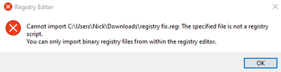

I am getting the following error trying to run reg edit??

 So, the bottom line with this error is that you have to apply the registry fix again whenever I get the error.  It doesn't seem to stay. But once applied, it works for a time. I was able to go a few weeks before it popped up again.
New Here ,
Jun 04, 2024 Jun 04, 2024
You don't have to do any registry edits for a more permanent fix.   Just open "printers and scanners"  and make the original change at that level vs. the printer properties each time you print.
