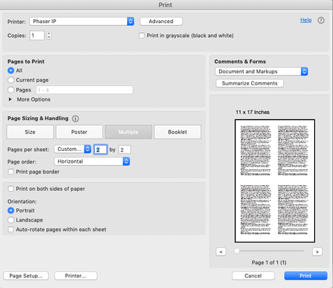

The trick is that you need to set up a custom paper size with no margins. Otherwise, Acrobat will automatically shrink your content to fit within the specified margins, regardless of the "Do Not Scale" checkbox.
Screen Shot 2019-10-15 at 4.20.31 PM.pngScreen Shot 2019-10-15 at 4.21.24 PM.png

Hey Document_Geek, try it just like you said and remove the margins using a tabloid page(11x17) with 4 smalles pages(5.5x8.5) in multiple option but its still shrinks the original pages from 5.5x8.5 to 5x8
