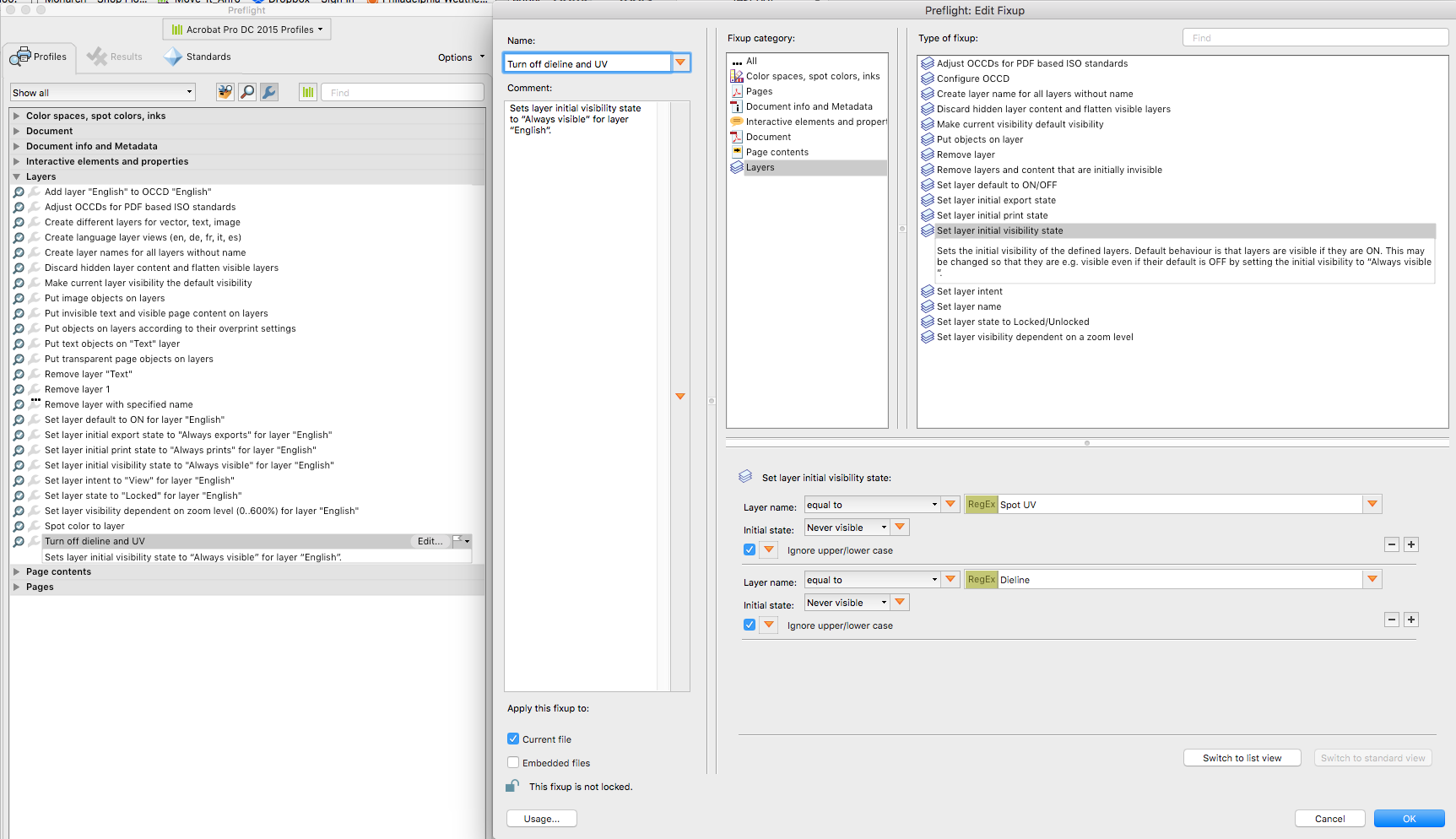

Guide ,
Jan 15, 2018 Jan 15, 2018
You might just need to turn off the visibility of the unwanted layers, if so, you can go to Tools> Print Production> Preflight> Fixups (blue wrench icon) and select Set layer initial visibility for layer English. Duplicate this fixup and re-name it. Edit it to include the names of the unwanted layers and change "Always Visible" to "Never Visible". You can create a new Action to run this preflight.
If you're sure you want to delete the unwanted layers, start with the preflight Remove layer with a specified name.
If your PDFs use spot colors that are not properly on their own separate layers, you can use a preflight to select the spot color and move it to a new layer with the name you specify.
