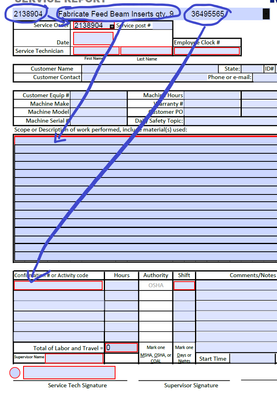

New Here ,
Jan 31, 2021 Jan 31, 2021
@try67 I have this some what working. My drop down menu has three rows of info, I would like to only pull the first seven characters into one text field "Service Order" and pull the very last eight characters into a seperate text field "comfirmation"  I would also like to add the middle info of the dropdwon into the "Description" text field. There is alot of variation amount of text in the middle of the drop down, but necessarily needed.
the code used in calculation
event.value = this.getField("ORDER").value
You can use the substring method to achieve it. See: https://www.w3schools.com/jsref/jsref_substring.asp

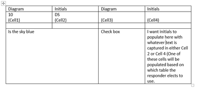

Aug 04, 2020 Aug 04, 2020
Hi
Thx for all your amazing knowledge @Try67. Your response to above helps in part and I am hoping you can shed some further light on this and how to progress it.
I have a digial form that has a number of sections completed by various individuals. I am trying to streamline it for staff by having their details autopopulate in the mandatory fields. However a table forms part of this section and not all rows will need to be populated. I want the questions that follow the table to be autopulated with the response in one of two cells reponded to in the table.
