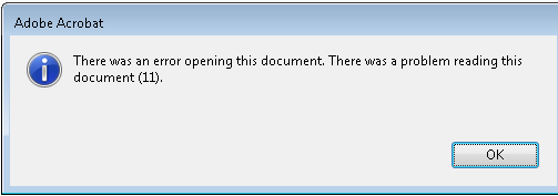

There was a problem reading this document (11) when using action wizard
Community Beginner ,
Jul 01, 2019 Jul 01, 2019
i am trying to optimize about 25.000 pdf's. After exactly 250 PDF's the process stops and the following error occurs:

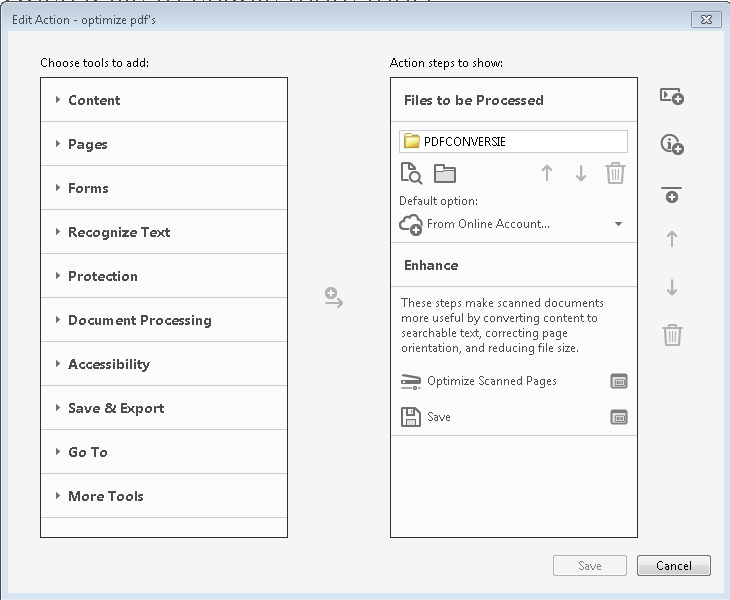

This is the action i am trying to use:
I want to do a Optimize Scanned Pages for all the pdf's in the folder PDFCONVERSIE.
When checking the memory usage i see that after every PDF which is converted the memory usage is increasing.
It looks like a memory leak.
Because Acrobat can use max 2 GIG it stops after (every time) 250 conversions.

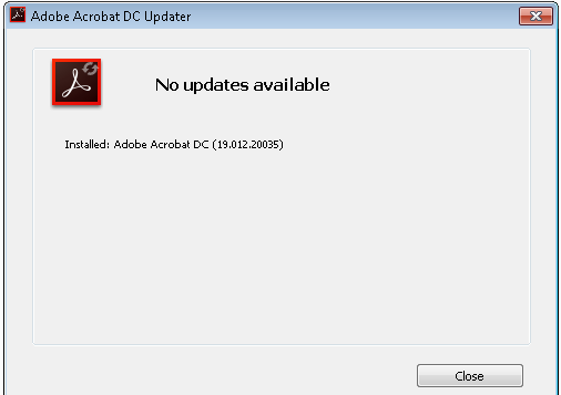

I am using the latest Adobe Acrobat DC (Pro) version:
Any suggestions?

Does it always stop after 250 documents - even when you process a different subset of your documents?
Acrobat’s action feature is not robust enough to run an unlimited number of jobs. There are resource leaks in Acrobat (at least that’s What it looks like from the outside) that create a limit of how many documents you can process in one batch. What this number is depends on the documents and the processing steps in your action. Try to limit your batches to 200 or even 100 documents and see if that makes a difference.
There is no option to run an action via the command line.

Yes it stops every time after 250 documents. And it doesn't matter if there are 25.000, 1.000 or 500 documents in the folder.
Smaller batches are indeed a solution but this was my first test with 25.000 documents. But there are 660.000 documents i have to compress.
Adobe seems the only tool who can do it this efficient. I have tried it with gostscript too, but that doesn't do this task efficient enough.

Acrobat is definitely not the tool for this job, I'm afraid.
