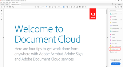

It should appear under Tools - Add-On Tools, like this:
If you're not seeing it make sure the Preferences are set as described, and also that "Enable Protected Mode" and "Enable Enhanced Security" are ticked OFF under the "Security (Enhanced)" tab of the Preferences dialog.
