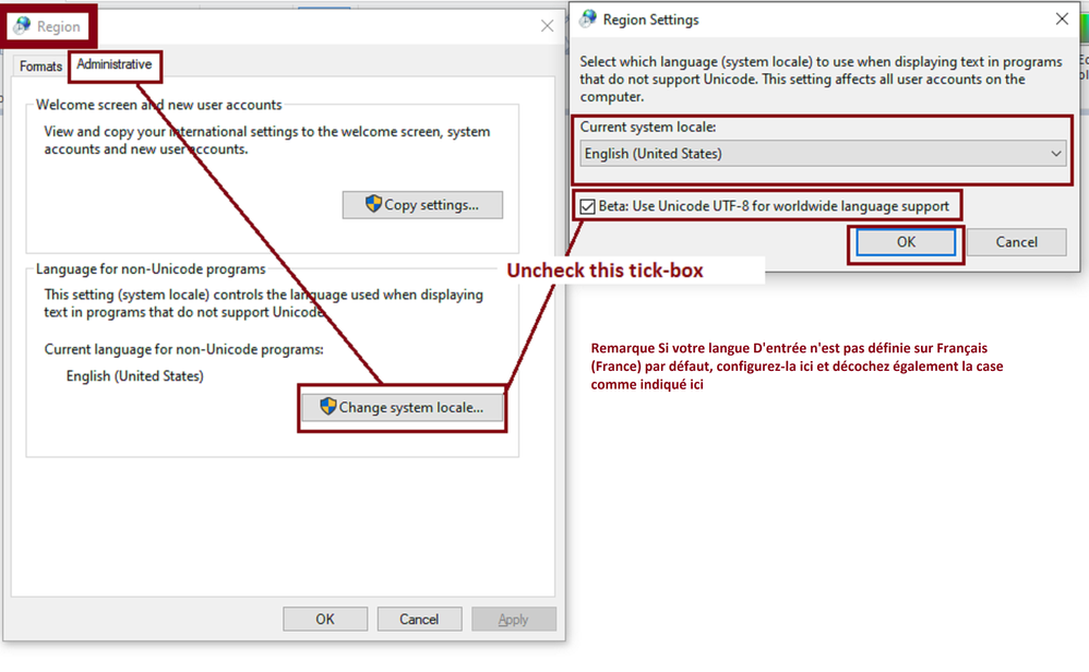

In my humble opinion, I think the problem was that you have set your default printer to Adobe PDF in your operating system, or , you manually chose that printer option from Firefox.
If yes, consider that using Adobe PDF as default printer uses UTF-8 for character encoding. And if you're on a MS Windows 10 machine, windows supports UTF-16 for character encoding natively. This means that a lot of API's will have to translate back and forth between UTF-8 and UTF-16 character encoding between applpications. If you didn't restart after the update took place, this could've triggered the problem.
If my suspicion is correct :
  • Also see slide below. Check if by disabling the option that I pointed out for you resolves the printing issue with  Firefox. A restart is required after you deselect that option.

- To be clear, I'm doing nothing I didn't do just fine yesterday.
- Yes, I rebooted after the update.
- I'm using the Adobe PDF driver, not a Firefox or any other type
plug-in.
- Per my latest post (which perhaps you haven't seen), all other
documents except the one I was having problems with seem to be printing
fine out of Firefox.
I think this was just a weird aberration, and if it doesn't flare up again,
I won't sweat it. But I'll keep in mind all that you have written, as that
was a lot of info I did not know! I appreciate it! Thanks much.
