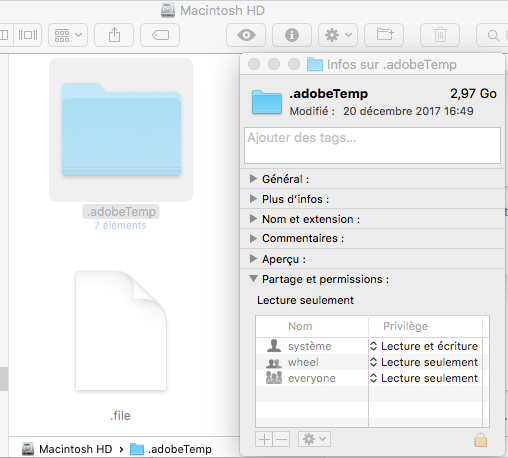

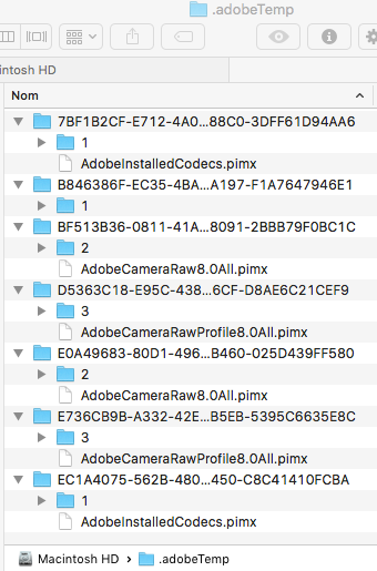

Here is my report:
As Adobe tools failed, i used Mac OS tools.
1) Displaying all files using Terminal:
defaults write com.apple.finder AppleShowAllFiles TRUE
killall Finder
2) Deleting files one by one.
3) A beautiful discovery: .adobeTemp (2ème degré : ironie).
Neither creativeCloud nor adobeCleaner deleted .adobeTemp
Guide ,
Jan 12, 2018 Jan 12, 2018
So: Solved.
Findings: On n'est si bien servi que par soi-même...
