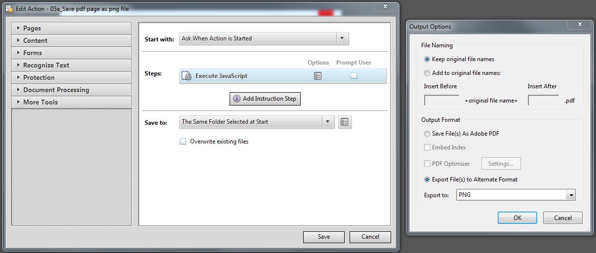

Explorer , Mar 15, 2017 Mar 15, 2017
So, the script did not do anything in my case. I did not change anything on the script, but then I went to dig into some other settings.
I have chosen following output settings.
Result is ok!
Do not ask me why the script doesn't do the same... That's still an open question for me.
Result is ok!

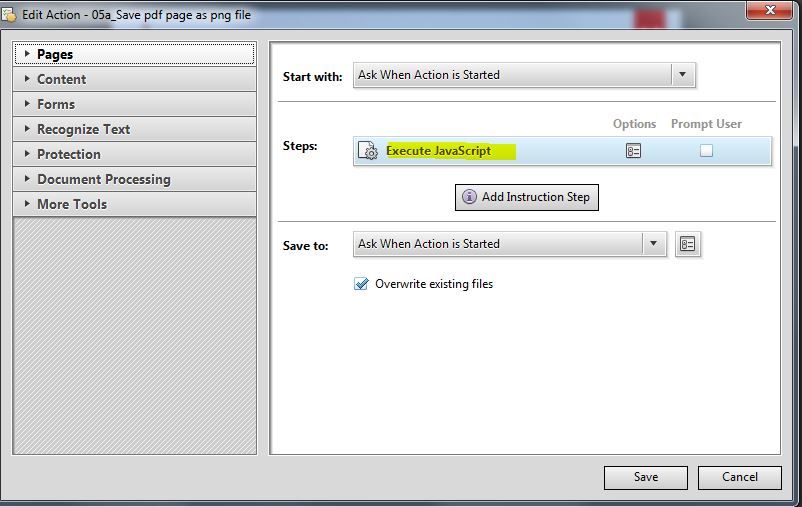

Explorer ,
I created a new sequence (see capture1)
The code can you find in my first call.
When I run the sequence, following message appears:
My conclusion was: something is wrong with script because the pop-up says that the pdf will be overwritten.
The problem still occurs as you can see above. No png is created at all. Acrobat X professional is used, friday update to DC.
I would set the Save To setting in the Action to "Do not save", since you're already doing it with your code...
