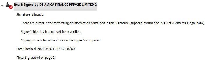

I am trying to sign the PDF using the Apache PDFBox library using a Class-2/3 cert. But, when I open the PDF in Acrobat Reader, I see a bunch of validation failures.. Attaching the sample pdf for reference..  Thanks.
Advocate ,
Jul 26, 2024 Jul 26, 2024
quote
Which bunch of validation failures? I only see one:
Looking into it, though, a number of issues become obvious:
  • There is no signature container embedded in the signature field value, instead the placeholder is filled with 0x00 bytes. This explains the message by Acrobat, a sequence of 0x00 bytes is not a valid signature container.
  • The gap in the ByteRange array starts at offset 482900. but the actual signature placeholder starts at offset 11036. This is not just off-by-1 or so, it's completely different.
  • The second range in the ByteRange array ends at offset 511033 but tghe file size is just 509215.
The first item indicates that the PDF has only been prepared for signing but no signature container has actually been embedded. The latter items indicate that after preparing for signing the PDF has again been opened and then saved regularly and not as a new revision by appending an incremental update.
The PDFBox example signing code does neither of these errors. Thus, please have a look at the PDFBox examples and do as they do.
