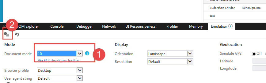

Feb 16, 2016 Feb 16, 2016
Hi davidhMKL,
This is in response to the issue, that you received the error "Unsupported browser" when using IE, please follow these steps
1) Click on settings (gear icon on the top right) > Compatibility View Settings > make sure the EchoSign.com is not added there, if added, please remove the site and un-check the box that says "Display sites in compatibility view" and click on close.
2) Click on F12 and when the developer tools open, please select Emulation > Document Mode to 10 and click on the icon on the top left of this section that says "Persist emulation settings disabled" so that it gets enabled (refer the screen shot attached).
Once that is done, please close and reopen Internet explorer and let me know if the site loads.
Aadesh
New Here ,
Hi Aadesh
I've already checked Compatibility View Settings and EchoSign.com isn't listed
In IE10 I cant see Emulation. The screen shot you have ask me to refer to is edge and not IE10 which is what we are using and having the problem with.
