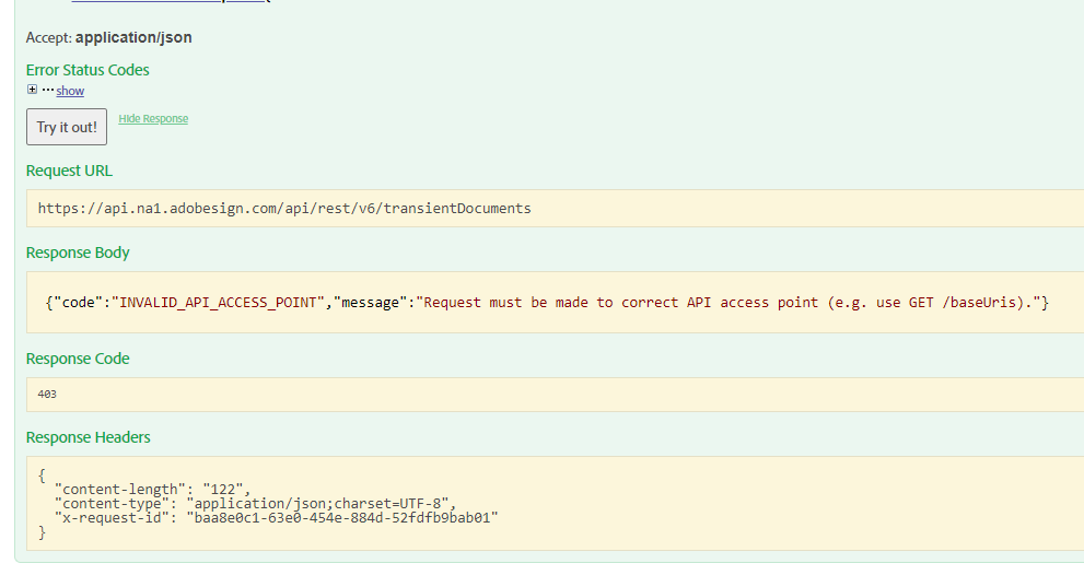

New Here ,
Aug 31, 2021 Aug 31, 2021
Hi Everybody,
I had tried to upload a document through the TRY IT OUT screen with my authorised account, this also showing the same errror message, I think the issue may be related to my account, that have to do something additionly. Anybody have any idea about the issue?
Please help me.
Thank you
Adobe Employee ,
Sep 01, 2021 Sep 01, 2021
Hi TonySbnt,
Sorry for the delay in response.
Please try changing the request URL from https://api.na1.adobesign.com to https://api.in1.adobesign.com and check if that works.
If the issue persists, then I would suggest to get in touch with the presales team. They will be able to provide you the pre-sales technical assistance and share the right information.
Please refer to the following link to get in contact with them: https://acrobat.adobe.com/us/en/sign/pricing/plans.html. You may use the contact button for Adobe Sign business and enterprise under the Multi-User tab.
Let us know how it goes.
Meenakshi
Adobe Employee ,
Sep 03, 2021 Sep 03, 2021
to provide more context, the api access point url needs to match the url your Sign account is hosted on. Sign accounts can be hosted in different reasons, but most documentation will only show the na1 shard.
Login your Sign account and check the url, it could be
secure.eu1.adobesign.com (or still echosign.com)
or secure.au1.adobesign.com.
Your api end points need to match the shard, eu1 and au1 in the above examples.
But to be absolulely sure call
get /baseUris
