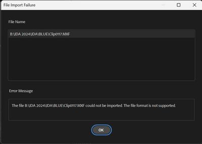

AME dialog box reads:
"File Import Failure"
Error Message:
"The file [path] could not be imported. The file format is not supported."

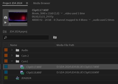

The same file imports, plays, etc. in both AE and PPro versions listed above, see the files imported into the project panels of each:
I would expect MXF files imported by AE/PPro to also be imported by AME.
